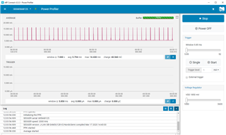

  • Hi
    I'm using nRF52833 DK running ble_app_hrs_freertos example.
    1. when using the following code:
            if ( xModifiableIdleTime > 0 )
    #ifdef SOFTDEVICE_PRESENT
                if (nrf_sdh_is_enabled())
    #if (__FPU_USED == 1)
                 __set_FPSCR(__get_FPSCR() & ~(0x0000009F));
                 (void) __get_FPSCR();
                 NVIC_ClearPendingIRQ(FPU_IRQn);
    #endif  __FPU_USED
                    uint32_t err_code = sd_app_evt_wait();
                else
    #endif  // SOFTDEVICE_PRESENT
                    /* No SD -  we would just block interrupts globally.
                    * BASEPRI cannot be used for that because it would prevent WFE from wake up.
                    do{
                        __WFE();
                    } while (0 == (NVIC->ISPR[0] | NVIC->ISPR[1]));
    the average power consumption is: 5.794mA
    sd_app_evt_wait
    2. when using the following code (forcing to use WFE):
    #if 0
    #endif  __FPU_USED
                else
    #endif  // if 0
                    do{
                        __WFE();
    the average power consumption is: 102uA
    WFE
