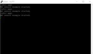

Problems with Nordic 52832 and i2c lsm303dlhc
I am trying to read through the nordic 52832 i2c an accelerometer datum lsm303dlhc using the example "twi sensor".
The code used is written below.
Unfortunately, the code starts working but cannot read any data.
I use this electrical connections:
SDA: 26
SCL:27

Reading the serial through "Putty" I read:
Can you help me? Thanks so much!!!
