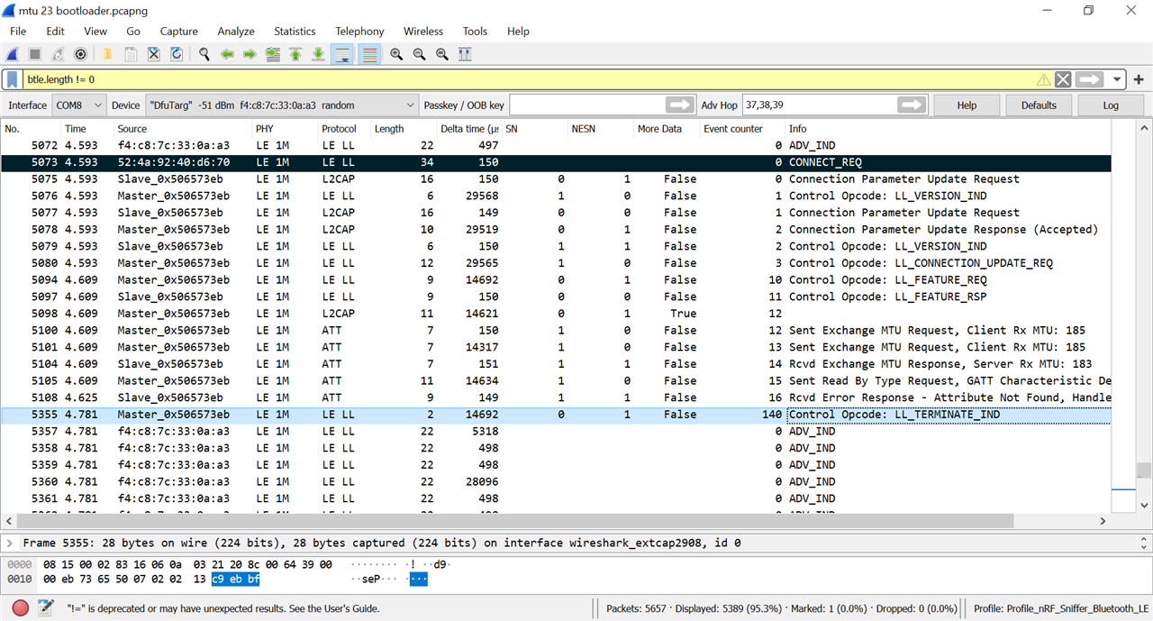

MTU exchange seems to fail, nRFConnect keeps reporting 23
I'm using nRF Connect to connect to the secure bootloader. In the debug log I see that an MTU of 185 is requested and 183 is replied. I also see this in the Wireshark log.
Strangely though, nRF Connect still reports a MTU of 23.
I've a similar problem with the actual firmware, but I thought it's best to initially solve the problem using your (more stable) code.At least for the firmware there have been times that other MTU sizes were reported by nRF Connect.
What am I missing? How can I make sure the MTU size is properly negotiated.
