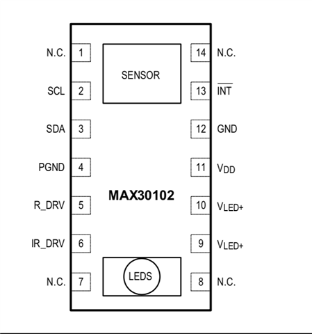

I am currently working on a project using the MAX30102 Heart rate module. This sensor has red & ir led's. I connected the the max30102 sensor to the nrf52 DK as follows
VDD -> VDD
GND -> GND
SDA -> P0.26
SCL -> P0.27
INT  -> P0.17
I have also connected the GND DETECT of the IO/Expander -> GND

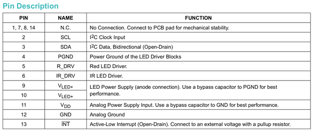

With this being said, the red led seems to be very faint and not bright enough. Im not sure if theres a problem with my connections or if i have to configure anything else. Any help would be appreciated. Attached pinout and description can be found.
    Do the LED light up regardless of whether the setup commands are sent on the TWI bus or not? Have you checked the bus with a logic analyzer to see if all the expected commands are sent? What happens inside write_register()?
    If the commands are sent correctly, the issue is most likely with other parts of the sensor connections, or with the commands. In this case you need to check the datasheet of the device if everything is correct.
