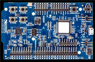

    nRF52832 dongle
    Nordic don't make such a thing - so please give details.
    Or did you mean an nRF52832 DK (Development Kit):
    https://www.nordicsemi.com/Software-and-Tools/Development-Kits/nRF52-DK
    Or an nRF52840 Dongle:
    https://www.nordicsemi.com/Software-and-tools/Development-Kits/nRF52840-Dongle
