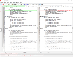

  • Dear Simon:
        I am very sorry about that I just noticed your name should be Simon and I use Simonr so many times. Sorry for the mistake.
       About the connection parameter, please look following screenshot:
       The timeout value is 5000ms and I think this should be long enough.  And this screenshot also contain the disconnect part.

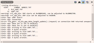

  • Hey
    I was able to locate an SD card reader and an SD card, and have been testing Jørgen's application (the ble_app_uart_fatfs_sdk141_keil_gcc_ses.zip example which allowed for debugging in SES). I have tested by using both my phone with the nRFConnect app (for Android), and a second DK with nRFConnect for Desktop but I have not been able to reproduce this error. Whenever I write to the UART.TXT file on the SD card, it returns successfully. Please see the attached debug log below
    Did you make any changes to the example application in order to reproduce this, or did you do anything special on your side in order to trigger this disconnect? Lastly, what SD card reader are you using?

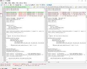

  • Dear Simon:
        I only modified 5 lines of code . Screenshot of compare as beblow:
       I think these modifications should not affect the behavior. So I think your test result is a good news. It seems that this issue is caused  by specific SD card. I will try to find some other SD card to check this issue and get back to you.
