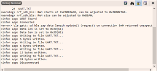

  • Hi again
    These pins should not be a problem to use, but I tested it just for good measure on my board as well, and I still don't have any trouble writing to the SD card as you can see in the screenshot from the debug terminal below (the disconnection was done manually by me in the nRFConnect app).
    The SD card I'm using is a 2GB microSD card, with a "regular" FAT format. Our examples should support what is described in the FatFs documentation. I think this format is limited to 4GB, so that might be your issue. You might have to edit some of the FatFs configurations to support larger cards, but I don't think we have tested this.
    The reason your board can't use the BLE app for nRFConnect is that only our first party kit SEGGER IDs are supported, as supporting all kinds of third-party devices would require way more maintenance and work than just our own boards.
