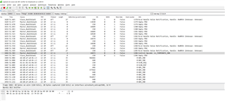

There is a sniffer log where the LL_TERMINATE_IND occur
