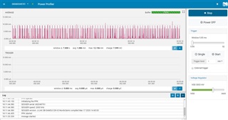

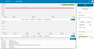

I have 3 different nRF52 DK eval boards versions
1. PCA10040 , 1.1.0.           2016.16
2. PCA10040 , 1.2.4.           2019.5
3. PCA10040 , 2.0.0.           2020.8

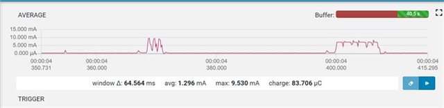

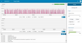

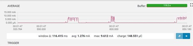

When I try to measure the current in boards 1 and 3 , they read varied values on same firmware flashed. (1) at ~3mA average current and with (3) ~49mA
What are the differences? I have cut the SB9 in order to measure the current.
I see the board components seem to have a difference, where can i find the schematics of these board implementation?
I measured current using nrf power profiler kit
Thank you!
Parents Reply
    Is the solder bridge from the SB9 cut properly? Does the kit function correctly i.e if you flash the blinky example from the SDK, does it work? What current do you measure if you flash the blinky example from the SDK on the board? What supply have you used earlier when you've tested the board? I'm suspecting that the board might be damaged.
