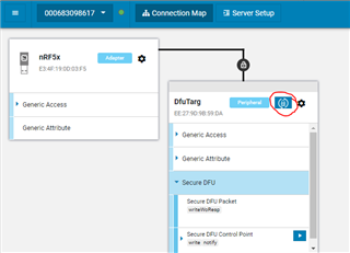

I also tried to perform the DFU through nRF Connect from mobile app-PC, but I cannot find the way to add the .zip packet in order to be sent(below the screenshot).
     Try to click the the blue DFU icon with the arrows around it:

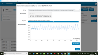

    - Thanks for the hint, sorry but I didn't notice it. I managed to correctly upload the zip folder and I tried to perform the DFU (the loading bar reached 100% and a message stating the successful end of the process appeared)
    - Unfortunately, the LEDs didn't start to blink! Note that if I upload the blinky example in the traditional way via USB (even after having uploaded the softdevice and the bootloader), it works correctly.

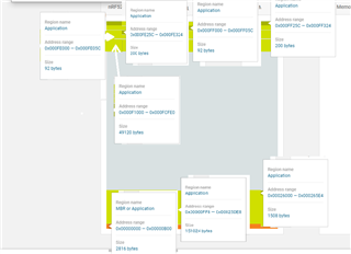

    This is the memory reading after uploading through DFU (I hope you can see):
    Do you have any suggestions?

    Yes, I see that the example found in SDK\examples\peripheral\blinky\pca10056\mbr doesn't like that there is a softdevice present. If you are using this example only for testing, I suggest that you test this with an example found in the SDK\examples\ble_peripheral folder, such as the ble_app_blinky. NB: it doesn't blink, but it lights up and starts advertising.

    • Then, I tried to upload via OTA DFU: I firstly uploaded SoftDevice and bootloader, I created the new package and I run the DFU. Differently to the blinky example, the program showed this loading bar(see the figure below), so I expected a good result this time. A message telling the successful end of the process appeared.
    • Unfortunately, after that, the device does not start advertising and all LEDs turn off apart from led5
    • Moreover, in the BLE application in nRF Connect, the device Scan do not find the target device anymore.

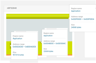

    The memory reading after the OTA DFU is similar to the one provided in the last comment, the differences are represented by the parts highlighted in the figure below:

    Can you double check that your bootloader and the application hex file you used to generate the application image use the same softdevice. What .hex file do you use to generate the application DFU image?
    If nRF Connect says the transfer completed successfully, then the application was transferred, so most likely, the application crashes before it starts advertising. Did you do any changes to the project? Perhaps you can try all this with a clean unmodified version of the SDK? And use the .hex file that is generated when you compile the project, and not the ones located in the SDK\example\ble_peripheral\ble_app_blinky\hex folder. Perhaps that was what you were doing?
