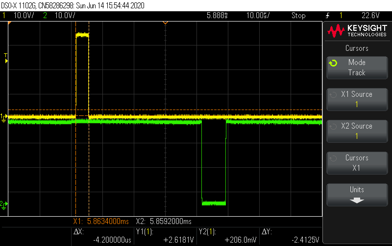

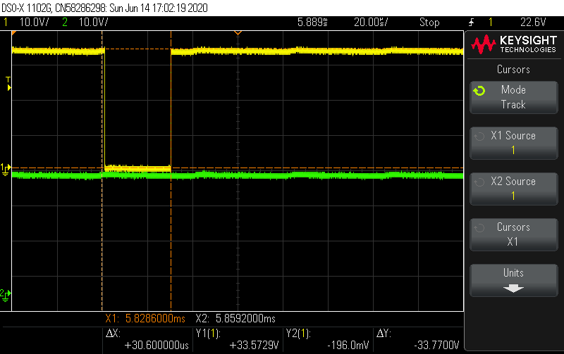

    When SPI CS = 26 IS ALONE
    The cs length is 30 Usec. see pic 52
    cs
    when SPI withe both cs is applied .
    The CS = 26 length is down to 4.2 u .  see pic 50
