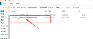

    Note that the S132 version supported in SDK 15.3.0 is not qualified for use with nRF52810, only s132 v5.1.0 is qualified.
    i did not find the ICF-file,where is it?
    Note that the S132 version supported in SDK 15.3.0 is not qualified for use with nRF52810, only s132 v5.1.0 is qualified. -->what you means?Do you mean that only SDK14.2 is suitable for developing 52810?
    becasue the s132v5.1.0 is support in SDK14.2
  • The .icf file is found in "$PROJ_DIR$\ble_app_uart_c_iar_nRF5x.icf". Did you not modify this file to change the Flash/RAM sizes?
    No, it means that s132 v5.1.0 is the only s132 softdevice that is qualified for use with nRF52810. This softdevice version is only supported in SDK 14.2. We chose to support this version and not the later ones because it has a bit smaller flash/RAM requirements, and support most of the desired features.
