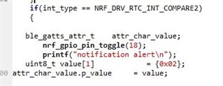

In my application I have a requirement to send notifications to mobile on triggering particular Interrupts as well as particular events.I have created a customised notification service having one character.I tried implementing in such a way that if interrupt occurs then it has to update ble_gatts_attr_t.p_value.The implemented code is attached below
I have just assigned a value to the member p_value.To reach my requirement I should be able to read value 02 in the characteristic value.For that purpose the given value must get updated into softdevice.Can you please let me know about any specific function call that would lead updating the value onto softdevice??
