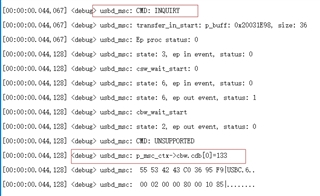

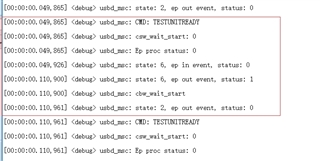

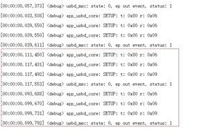

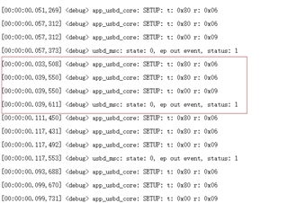

  • Hi Edvin:
    1. Normal log:
    2. The log when the exception occurs, the command changes;
    3. When I check, log printing stays here;
    4. When the file is operated again, the subsequent parts are printed one after another
    5. log attachment

    [00:00:00.035,461] <debug> usbd_msc: state: 6, ep in event, status: 0
    [00:00:00.096,496] <debug> usbd_msc: state: 6, ep out event, status: 1
    [00:00:00.096,496] <debug> usbd_msc: cbw_wait_start
    [00:00:00.096,496] <debug> usbd_msc: state: 2, ep out event, status: 0
    [00:00:00.096,496] <debug> usbd_msc: CMD: TESTUNITREADY
    [00:00:00.096,496] <debug> usbd_msc: csw_wait_start: 0
    [00:00:00.096,496] <debug> usbd_msc: Ep proc status: 0
    [00:00:00.096,496] <debug> usbd_msc: state: 6, ep in event, status: 0
    [00:00:00.032,531] <debug> usbd_msc: state: 6, ep out event, status: 1
    [00:00:00.032,531] <debug> usbd_msc: cbw_wait_start
    [00:00:00.032,531] <debug> usbd_msc: state: 2, ep out event, status: 0
    [00:00:00.032,531] <debug> usbd_msc: CMD: TESTUNITREADY
    [00:00:00.032,531] <debug> usbd_msc: csw_wait_start: 0
    [00:00:00.032,531] <debug> usbd_msc: Ep proc status: 0
    [00:00:00.032,531] <debug> usbd_msc: state: 6, ep in event, status: 0
    [00:00:00.093,566] <debug> usbd_msc: state: 6, ep out event, status: 1
    [00:00:00.093,566] <debug> usbd_msc: cbw_wait_start
    [00:00:00.093,627] <debug> usbd_msc: state: 2, ep out event, status: 0
    [00:00:00.093,627] <debug> usbd_msc: CMD: TESTUNITREADY
    [00:00:00.093,627] <debug> usbd_msc: csw_wait_start: 0
    [00:00:00.093,627] <debug> usbd_msc: Ep proc status: 0
    [00:00:00.093,627] <debug> usbd_msc: state: 6, ep in event, status: 0
    [00:00:00.029,663] <debug> usbd_msc: state: 6, ep out event, status: 1
    [00:00:00.029,663] <debug> usbd_msc: cbw_wait_start
    [00:00:00.029,663] <debug> usbd_msc: state: 2, ep out event, status: 0
    [00:00:00.029,663] <debug> usbd_msc: CMD: TESTUNITREADY
    [00:00:00.029,663] <debug> usbd_msc: csw_wait_start: 0
    [00:00:00.029,663] <debug> usbd_msc: Ep proc status: 0
    [00:00:00.029,663] <debug> usbd_msc: state: 6, ep in event, status: 0
    [00:00:00.090,698] <debug> usbd_msc: state: 6, ep out event, status: 1
    [00:00:00.090,698] <debug> usbd_msc: cbw_wait_start
    [00:00:00.090,698] <debug> usbd_msc: state: 2, ep out event, status: 0
    [00:00:00.090,698] <debug> usbd_msc: CMD: TESTUNITREADY
    [00:00:00.090,698] <debug> usbd_msc: csw_wait_start: 0
    [00:00:00.090,698] <debug> usbd_msc: Ep proc status: 0
    [00:00:00.090,698] <debug> usbd_msc: state: 6, ep in event, status: 0
    [00:00:00.026,733] <debug> usbd_msc: state: 6, ep out event, status: 1
    [00:00:00.026,733] <debug> usbd_msc: cbw_wait_start
    [00:00:00.026,794] <debug> usbd_msc: state: 2, ep out event, status: 0
    [00:00:00.026,794] <debug> usbd_msc: CMD: TESTUNITREADY
    [00:00:00.026,794] <debug> usbd_msc: csw_wait_start: 0
    [00:00:00.026,794] <debug> usbd_msc: Ep proc status: 0
    [00:00:00.026,794] <debug> usbd_msc: state: 6, ep in event, status: 0
    [00:00:00.087,829] <debug> usbd_msc: state: 6, ep out event, status: 1
    [00:00:00.087,829] <debug> usbd_msc: cbw_wait_start
    [00:00:00.087,829] <debug> usbd_msc: state: 2, ep out event, status: 0
    [00:00:00.087,829] <debug> usbd_msc: CMD: TESTUNITREADY
    [00:00:00.087,829] <debug> usbd_msc: csw_wait_start: 0
    [00:00:00.087,829] <debug> usbd_msc: Ep proc status: 0
    [00:00:00.087,829] <debug> usbd_msc: state: 6, ep in event, status: 0
    [00:00:00.023,864] <debug> usbd_msc: state: 6, ep out event, status: 1
    [00:00:00.023,864] <debug> usbd_msc: cbw_wait_start
    [00:00:00.023,864] <debug> usbd_msc: state: 2, ep out event, status: 0
    [00:00:00.023,864] <debug> usbd_msc: CMD: TESTUNITREADY
    [00:00:00.023,864] <debug> usbd_msc: csw_wait_start: 0
    [00:00:00.023,864] <debug> usbd_msc: Ep proc status: 0
    [00:00:00.023,925] <debug> usbd_msc: state: 6, ep in event, status: 0
    [00:00:00.084,899] <debug> usbd_msc: state: 6, ep out event, status: 1
    [00:00:00.084,899] <debug> usbd_msc: cbw_wait_start
    [00:00:00.084,899] <debug> usbd_msc: state: 2, ep out event, status: 0
    [00:00:00.084,899] <debug> usbd_msc: CMD: TESTUNITREADY
    [00:00:00.084,899] <debug> usbd_msc: csw_wait_start: 0
    [00:00:00.084,899] <debug> usbd_msc: Ep proc status: 0
    [00:00:00.084,960] <debug> usbd_msc: state: 6, ep in event, status: 0
    [00:00:00.020,996] <debug> usbd_msc: state: 6, ep out event, status: 1
    [00:00:00.020,996] <debug> usbd_msc: cbw_wait_start
    [00:00:00.020,996] <debug> usbd_msc: state: 2, ep out event, status: 0
    [00:00:00.020,996] <debug> usbd_msc: CMD: TESTUNITREADY
    [00:00:00.020,996] <debug> usbd_msc: csw_wait_start: 0
    [00:00:00.020,996] <debug> usbd_msc: Ep proc status: 0
    [00:00:00.020,996] <debug> usbd_msc: state: 6, ep in event, status: 0
    [00:00:00.082,031] <debug> usbd_msc: state: 6, ep out event, status: 1
    [00:00:00.082,031] <debug> usbd_msc: cbw_wait_start
    [00:00:00.082,031] <debug> usbd_msc: state: 2, ep out event, status: 0
    [00:00:00.082,031] <debug> usbd_msc: CMD: TESTUNITREADY
    [00:00:00.082,031] <debug> usbd_msc: csw_wait_start: 0
    [00:00:00.082,031] <debug> usbd_msc: Ep proc status: 0
    [00:00:00.082,031] <debug> usbd_msc: state: 6, ep in event, status: 0
    [00:00:00.018,066] <debug> usbd_msc: state: 6, ep out event, status: 1
    [00:00:00.018,066] <debug> usbd_msc: cbw_wait_start
    [00:00:00.018,066] <debug> usbd_msc: state: 2, ep out event, status: 0
    [00:00:00.018,066] <debug> usbd_msc: CMD: TESTUNITREADY
    [00:00:00.018,066] <debug> usbd_msc: csw_wait_start: 0
    [00:00:00.018,066] <debug> usbd_msc: Ep proc status: 0
    [00:00:00.018,127] <debug> usbd_msc: state: 6, ep in event, status: 0
    [00:00:00.079,162] <debug> usbd_msc: state: 6, ep out event, status: 1
    [00:00:00.079,162] <debug> usbd_msc: cbw_wait_start
    [00:00:00.079,162] <debug> usbd_msc: state: 2, ep out event, status: 0
    [00:00:00.079,162] <debug> usbd_msc: CMD: TESTUNITREADY
    [00:00:00.079,162] <debug> usbd_msc: csw_wait_start: 0
    [00:00:00.079,162] <debug> usbd_msc: Ep proc status: 0
    [00:00:00.079,162] <debug> usbd_msc: state: 6, ep in event, status: 0
    [00:00:00.015,197] <debug> usbd_msc: state: 6, ep out event, status: 1
    [00:00:00.015,197] <debug> usbd_msc: cbw_wait_start
    [00:00:00.015,197] <debug> usbd_msc: state: 2, ep out event, status: 0
    [00:00:00.015,197] <debug> usbd_msc: CMD: TESTUNITREADY
    [00:00:00.015,197] <debug> usbd_msc: csw_wait_start: 0
    [00:00:00.015,197] <debug> usbd_msc: Ep proc status: 0
    [00:00:00.015,197] <debug> usbd_msc: state: 6, ep in event, status: 0
    [00:00:00.076,232] <debug> usbd_msc: state: 6, ep out event, status: 1
    [00:00:00.076,232] <debug> usbd_msc: cbw_wait_start
    [00:00:00.076,232] <debug> usbd_msc: state: 2, ep out event, status: 0
    [00:00:00.076,232] <debug> usbd_msc: CMD: TESTUNITREADY
    [00:00:00.076,232] <debug> usbd_msc: csw_wait_start: 0
    [00:00:00.076,232] <debug> usbd_msc: Ep proc status: 0
    [00:00:00.076,293] <debug> usbd_msc: state: 6, ep in event, status: 0
    [00:00:00.012,329] <debug> usbd_msc: state: 6, ep out event, status: 1
    [00:00:00.012,329] <debug> usbd_msc: cbw_wait_start
    [00:00:00.012,329] <debug> usbd_msc: state: 2, ep out event, status: 0
    [00:00:00.012,329] <debug> usbd_msc: CMD: TESTUNITREADY
    [00:00:00.012,329] <debug> usbd_msc: csw_wait_start: 0
    [00:00:00.012,329] <debug> usbd_msc: Ep proc status: 0
    [00:00:00.012,329] <debug> usbd_msc: state: 6, ep in event, status: 0
    [00:00:00.073,364] <debug> usbd_msc: state: 6, ep out event, status: 1
    [00:00:00.073,364] <debug> usbd_msc: cbw_wait_start
    [00:00:00.073,364] <debug> usbd_msc: state: 2, ep out event, status: 0
    [00:00:00.073,364] <debug> usbd_msc: CMD: TESTUNITREADY
    [00:00:00.073,364] <debug> usbd_msc: csw_wait_start: 0
    [00:00:00.073,364] <debug> usbd_msc: Ep proc status: 0
    [00:00:00.073,364] <debug> usbd_msc: state: 6, ep in event, status: 0
    [00:00:00.009,460] <debug> usbd_msc: state: 6, ep out event, status: 1
    [00:00:00.009,460] <debug> usbd_msc: cbw_wait_start
    [00:00:00.009,460] <debug> usbd_msc: state: 2, ep out event, status: 0
    [00:00:00.009,460] <debug> usbd_msc: CMD: TESTUNITREADY
    [00:00:00.009,460] <debug> usbd_msc: csw_wait_start: 0
    [00:00:00.009,460] <debug> usbd_msc: Ep proc status: 0
    [00:00:00.009,460] <debug> usbd_msc: state: 6, ep in event, status: 0
    [00:00:00.070,495] <debug> usbd_msc: state: 6, ep out event, status: 1
    [00:00:00.070,495] <debug> usbd_msc: cbw_wait_start
    [00:00:00.070,495] <debug> usbd_msc: state: 2, ep out event, status: 0
    [00:00:00.070,495] <debug> usbd_msc: CMD: TESTUNITREADY
    [00:00:00.070,495] <debug> usbd_msc: csw_wait_start: 0
    [00:00:00.070,495] <debug> usbd_msc: Ep proc status: 0
    [00:00:00.070,495] <debug> usbd_msc: state: 6, ep in event, status: 0
    [00:00:00.006,530] <debug> usbd_msc: state: 6, ep out event, status: 1
    [00:00:00.006,530] <debug> usbd_msc: cbw_wait_start
    [00:00:00.006,530] <debug> usbd_msc: state: 2, ep out event, status: 0
    [00:00:00.006,530] <debug> usbd_msc: CMD: TESTUNITREADY
    [00:00:00.006,530] <debug> usbd_msc: csw_wait_start: 0
    [00:00:00.006,530] <debug> usbd_msc: Ep proc status: 0
    [00:00:00.006,530] <debug> usbd_msc: state: 6, ep in event, status: 0
    [00:00:00.067,565] <debug> usbd_msc: state: 6, ep out event, status: 1
    [00:00:00.067,565] <debug> usbd_msc: cbw_wait_start
    [00:00:00.067,565] <debug> usbd_msc: state: 2, ep out event, status: 0
    [00:00:00.067,565] <debug> usbd_msc: CMD: TESTUNITREADY
    [00:00:00.067,565] <debug> usbd_msc: csw_wait_start: 0
    [00:00:00.067,565] <debug> usbd_msc: Ep proc status: 0
    [00:00:00.067,626] <debug> usbd_msc: state: 6, ep in event, status: 0
    [00:00:00.003,662] <debug> usbd_msc: state: 6, ep out event, status: 1
    [00:00:00.003,662] <debug> usbd_msc: cbw_wait_start
    [00:00:00.003,662] <debug> usbd_msc: state: 2, ep out event, status: 0
    [00:00:00.003,662] <debug> usbd_msc: CMD: TESTUNITREADY
    [00:00:00.003,662] <debug> usbd_msc: csw_wait_start: 0
    [00:00:00.003,662] <debug> usbd_msc: Ep proc status: 0
    [00:00:00.003,662] <debug> usbd_msc: state: 6, ep in event, status: 0
    [00:00:00.064,697] <debug> usbd_msc: state: 6, ep out event, status: 1
    [00:00:00.064,697] <debug> usbd_msc: cbw_wait_start
    [00:00:00.064,697] <debug> usbd_msc: state: 2, ep out event, status: 0
    [00:00:00.064,697] <debug> usbd_msc: CMD: TESTUNITREADY
    [00:00:00.064,697] <debug> usbd_msc: csw_wait_start: 0
    [00:00:00.064,697] <debug> usbd_msc: Ep proc status: 0
    [00:00:00.064,697] <debug> usbd_msc: state: 6, ep in event, status: 0
    [00:00:00.000,732] <debug> usbd_msc: state: 6, ep out event, status: 1
    [00:00:00.000,732] <debug> usbd_msc: cbw_wait_start
    [00:00:00.000,732] <debug> usbd_msc: state: 2, ep out event, status: 0
    [00:00:00.000,732] <debug> usbd_msc: CMD: TESTUNITREADY
    [00:00:00.000,732] <debug> usbd_msc: csw_wait_start: 0
    [00:00:00.000,732] <debug> usbd_msc: Ep proc status: 0
    [00:00:00.000,793] <debug> usbd_msc: state: 6, ep in event, status: 0
    [00:00:00.061,828] <debug> usbd_msc: state: 6, ep out event, status: 1
    [00:00:00.061,828] <debug> usbd_msc: cbw_wait_start
    [00:00:00.061,828] <debug> usbd_msc: state: 2, ep out event, status: 0
    [00:00:00.061,828] <debug> usbd_msc: CMD: TESTUNITREADY
    [00:00:00.061,828] <debug> usbd_msc: csw_wait_start: 0
    [00:00:00.061,828] <debug> usbd_msc: Ep proc status: 0
    [00:00:00.061,828] <debug> usbd_msc: state: 6, ep in event, status: 0
    [00:00:00.122,863] <debug> usbd_msc: state: 6, ep out event, status: 1
    [00:00:00.122,863] <debug> usbd_msc: cbw_wait_start
    [00:00:00.122,863] <debug> usbd_msc: state: 2, ep out event, status: 0
    [00:00:00.122,863] <debug> usbd_msc: CMD: TESTUNITREADY
    [00:00:00.122,863] <debug> usbd_msc: csw_wait_start: 0
    [00:00:00.122,863] <debug> usbd_msc: Ep proc status: 0
    [00:00:00.122,863] <debug> usbd_msc: state: 6, ep in event, status: 0
    [00:00:00.058,898] <debug> usbd_msc: state: 6, ep out event, status: 1
    [00:00:00.058,898] <debug> usbd_msc: cbw_wait_start
    [00:00:00.058,898] <debug> usbd_msc: state: 2, ep out event, status: 0
    [00:00:00.058,898] <debug> usbd_msc: CMD: TESTUNITREADY
    [00:00:00.058,898] <debug> usbd_msc: csw_wait_start: 0
    [00:00:00.058,898] <debug> usbd_msc: Ep proc status: 0
    [00:00:00.058,959] <debug> usbd_msc: state: 6, ep in event, status: 0
    [00:00:00.119,995] <debug> usbd_msc: state: 6, ep out event, status: 1
    [00:00:00.119,995] <debug> usbd_msc: cbw_wait_start
    [00:00:00.119,995] <debug> usbd_msc: state: 2, ep out event, status: 0
    [00:00:00.119,995] <debug> usbd_msc: CMD: TESTUNITREADY
    [00:00:00.119,995] <debug> usbd_msc: csw_wait_start: 0
    [00:00:00.119,995] <debug> usbd_msc: Ep proc status: 0
    [00:00:00.119,995] <debug> usbd_msc: state: 6, ep in event, status: 0
    [00:00:00.056,030] <debug> usbd_msc: state: 6, ep out event, status: 1
    [00:00:00.056,030] <debug> usbd_msc: cbw_wait_start
    [00:00:00.056,030] <debug> usbd_msc: state: 2, ep out event, status: 0
    [00:00:00.056,030] <debug> usbd_msc: CMD: TESTUNITREADY
    [00:00:00.056,030] <debug> usbd_msc: csw_wait_start: 0
    [00:00:00.056,030] <debug> usbd_msc: Ep proc status: 0
    [00:00:00.056,030] <debug> usbd_msc: state: 6, ep in event, status: 0
    [00:00:00.117,065] <debug> usbd_msc: state: 6, ep out event, status: 1
    [00:00:00.117,065] <debug> usbd_msc: cbw_wait_start
    [00:00:00.117,065] <debug> usbd_msc: state: 2, ep out event, status: 0
    [00:00:00.117,065] <debug> usbd_msc: CMD: TESTUNITREADY
    [00:00:00.117,065] <debug> usbd_msc: csw_wait_start: 0
    [00:00:00.117,065] <debug> usbd_msc: Ep proc status: 0
    [00:00:00.117,126] <debug> usbd_msc: state: 6, ep in event, status: 0
    [00:00:00.053,161] <debug> usbd_msc: state: 6, ep out event, status: 1
    [00:00:00.053,161] <debug> usbd_msc: cbw_wait_start
    [00:00:00.053,161] <debug> usbd_msc: state: 2, ep out event, status: 0

    [00:00:00.027,099] <debug> usbd_msc: CMD: TESTUNITREADY
    [00:00:00.027,099] <debug> usbd_msc: csw_wait_start: 0
    [00:00:00.027,099] <debug> usbd_msc: Ep proc status: 0
    [00:00:00.027,160] <debug> usbd_msc: state: 6, ep in event, status: 0

    [00:00:00.044,067] <debug> usbd_msc: CMD: INQUIRY
    [00:00:00.044,067] <debug> usbd_msc: transfer_in_start: p_buff: 0x20031E98, size: 36
    [00:00:00.044,067] <debug> usbd_msc: Ep proc status: 0
    [00:00:00.044,128] <debug> usbd_msc: state: 3, ep in event, status: 0
    [00:00:00.044,128] <debug> usbd_msc: csw_wait_start: 0
    [00:00:00.044,128] <debug> usbd_msc: state: 6, ep in event, status: 0
    [00:00:00.044,128] <debug> usbd_msc: state: 6, ep out event, status: 1
    [00:00:00.044,128] <debug> usbd_msc: cbw_wait_start
    [00:00:00.044,128] <debug> usbd_msc: state: 2, ep out event, status: 0
    [00:00:00.044,128] <debug> usbd_msc: CMD: UNSUPPORTED
    [00:00:00.044,128] <debug> usbd_msc: p_msc_ctx->cbw.cdb[0]=133

    [00:00:00.033,508] <debug> app_usbd_core: SETUP: t: 0x80 r: 0x06
    [00:00:00.039,550] <debug> app_usbd_core: SETUP: t: 0x80 r: 0x06
    [00:00:00.039,550] <debug> app_usbd_core: SETUP: t: 0x00 r: 0x09
    [00:00:00.039,611] <debug> usbd_msc: state: 0, ep out event, status: 1
    [00:00:00.111,450] <debug> app_usbd_core: SETUP: t: 0x80 r: 0x06
    [00:00:00.117,431] <debug> app_usbd_core: SETUP: t: 0x80 r: 0x06
    [00:00:00.117,492] <debug> app_usbd_core: SETUP: t: 0x00 r: 0x09
    [00:00:00.117,553] <debug> usbd_msc: state: 0, ep out event, status: 1
    [00:00:00.093,688] <debug> app_usbd_core: SETUP: t: 0x80 r: 0x06
    [00:00:00.099,670] <debug> app_usbd_core: SETUP: t: 0x80 r: 0x06
    [00:00:00.099,731] <debug> app_usbd_core: SETUP: t: 0x00 r: 0x09
    [00:00:00.099,792] <debug> usbd_msc: state: 0, ep out event, status: 1
