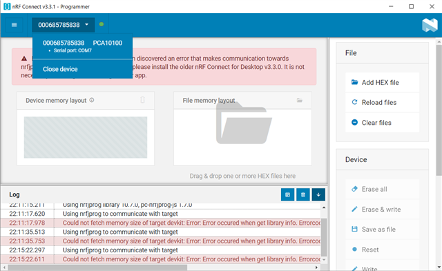

    This is what I see now when I try to connect to the DK
    the log entry in red reads:
    "Could not fetch memory size of target devkit: Error: Error occured when get library info. Errorcode: CouldNotOpenDevice (0x4) Lowlevel error: JLINKARM_DLL_ERROR (ffffff9a)"
    I tried typing on command line: nrfjprog --recover
    I get:
    C:\Users\bash\OneDrive\Desktop>nrfjprog --recover
    ERROR: JLinkARM DLL reported an error. Try again. If error condition
    ERROR: persists, run the same command again with argument --log, contact Nordic
    ERROR: Semiconductor and provide the generated log.log file to them.
    I also logged the above command with nrfjprog --recover --log.
    I have attached the log at the appendix of this message.
    So I downloaded the Interface MCU binary, turned off DK, held down IF BOOT/RESET, turned back on DK.
    Interface LED does turn on and flash when I drag and drop Interface MCU binary (it keeps flashing indefinitely and USB connectivity to PC is lost).
    I turn off/turn back on the DK and I try again to connect via nRF Connect, to no avail.
    Also, the nRF52840-Dongle is absolutely bricked too. When I connect it directly to the PC, no lights turn on, and the PC does not even recognize a plugged in USB device.
    If I could save the DK I would be over the moon. Thank you in advance.
