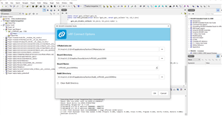

I modified the gpio interrupt on the asset_tracker example of ncs v1.2, modified the following, and the interrupt didn't work:
Where is available should be modified.
I set the interrupt port to 8 feet to enter the interrupt
I set the interrupt port to 15 feet and i can't get into the break.
The default configuration code is as follows:
