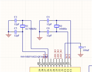

What do you use as your LFCLK on your PCB? Do you use the RC oscillator, or an external LFXTAL?

What is the HW that you are running on? Is it a DK or a custom board? If it is a custom board, what HFXTAL do you use? Is the accuracy on this similar to the one on the DK?

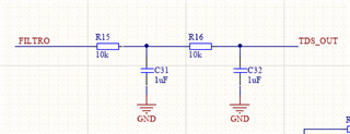

What exactly are you measureing? Remember that measuring with the ADC draws a bit of current. If it is a battery you are measuring, or something else with a high internal resistance, it may drop the voltage over that device just as you measure, and even more if you draw more current from the device, such as a radio spike or something). Have you tried to monitor the input voltage with an oscilloscope to see if there is an actual drop in voltage?

Hi Edvin,
I use a NRF51822.-QFAC
I use the same HFXTAL than in your designs (NX2520SA-16MHZ-STD-CSW-5)
I use 1/3 prescaler
I use 3V as VCC
I am trying to measure this (please, tell me if i need any other hardware part):
1) Battery :
2) Sensor 1: (output of an OAMP directly connected to the ADC)
3) Sensor 2: (output of an OAMP connected to the ADC with this through)
