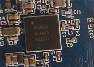

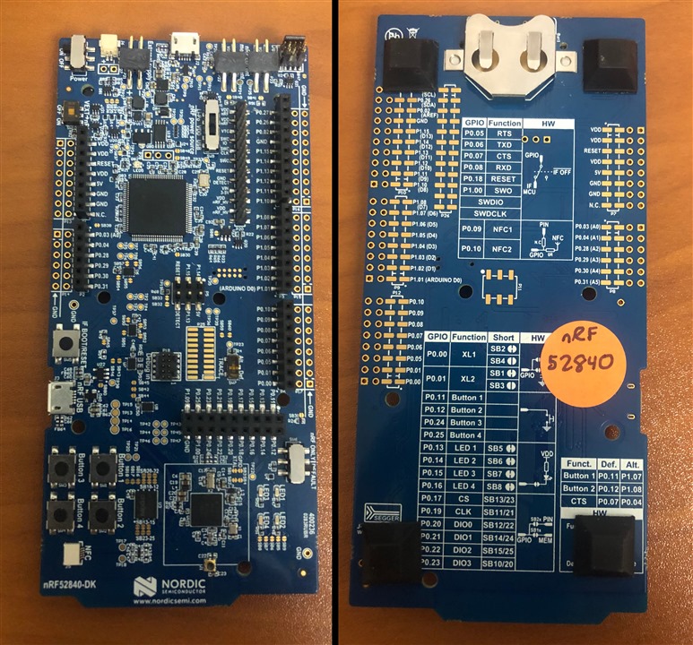

 We are integrating the nRF52840 into a new test apparatus and I am using the nRF52840-DK for development. I have pulled out my unit from storage and it will not power on, I observe the following -
Observations:
  • Config - SW8:On, SW9: Vdd, SW6: Default
  • Cold_Power-on (Connect J2-USB to PC): No response (Device Manager or USBDeview reports)
  • RESET_Power-on: (Depress IF BOOT/RESET, Connect J2-USB to PC):
    • LED5: Blink @ ~1Hz
    • Device Manager shows activity (no Ports activity), keeps resetting
    • USBDeview flashes but reports no content updates
Question:
  • How do I get this unit back into development use? We have the nRF52832-DK and it works appropriately, if useful
