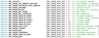

    Could you tell me exactly which error the nrf_drv_twi_tx is generating?
    You can see the possible errors in the function API Reference documentation.
    As a sidenote, I would recommend using the nrfx_TWIM driver directly instead of the nrf_drv, since this is the legacy layer.
    Depending on your configuration, you can see that it is what is being called by your nrf_drv_* call anyways.

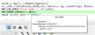

  • Sorry about that, I was trying to think of the best way to be able to provide you an error code without using a breakpoint but, it turns out, when it gets stuck at that NRF_BREAKPOINT_COND, I can still read the error code (I tried having it output using the NRF_LOG_INFO command but it didn't actually output anything for one reason or another).  Well, I hovered over the error code and it gave me error code 17:
    I assume this means it's busy?
    I guess it would make sense to me that it suddenly started working if I put the break point, it's giving it a delay that could give it enough time to complete.
    I placed a delay of 230 us (had to play around with it to minimize the time) and that seemed to work.  I could also play with the function handling of the error but I don't really understand how it coming back as busy would halt the entire program and generate that failure code.  Do you have any insight on why this might be?
    Is the TWIM driver a bit more robust?  Would it provide better handling of this situation that wouldn't break the code in this way?  If so, does the nRF SDK have any good examples you would point me to?  I assume TWIM is setup a bit differently from TWI_DRV.
    Any insight you can give me would be very helpful!  Thanks again for all your help!

    You did not specify any formatting argument to your string. To print the value of an uint32_t, you could for example use the %lu with a typecast:
    NRF_LOG_INFO("Error code: %lu", (unsigned long)err_code);
    Or similar.
    Have you made any modification to the error handler function?
    The default handler for _any_ error(anything else then NRF_SUCCESS) is to reset the device, however you are free to implement any error handling you see fit.
    In your particular case, the error code is generates by the call to nrf_drv_twi_tx and the different possible reasons can be read about in the functions API Reference documentation.
    The BUSY error indicates that the driver is not ready for another transfer, which leads me to believe that you are toggling your transfer_finished flag too soon.
    For example, adding a delay might not be the best solution - at least not implemented using the us_delay function - since it wastes CPI cycles, and prevents the rest of the program from running.
    Perhaps instead you could have the error handler for TWI BUSY state could start a timer for 230 us, that does not allow other TWI operations to occur before the timer has run out - or something similar. Keep in mind that I do not know the full extent of your application, and as such this might be a sub-par solution for your project.
    As a general tip, I would not recommend using CPU NOP cycles to solve any timing related problems during operation.
    You could also make use of repeated transfers, as detailed by my colleague in this ticket, but it is a bit more complicated to set up properly.

    I did try your suggestion for the log:
    It definitely output the error code but it took about 2.5 ms to run, so that will probably need to be saved for diagnostics rather than regular output!
    I didn't realize that any unhandled error defaults to resetting the device!  That's good to know!
    I ended up finding a solution that cut down the time considerably!  Instead of the 260 us (which, oddly enough, only seemed to add something like 160 us, according to the scope . . . which I won't lie, was a bit concerning.  Could be part of the reason for the error, I'm guessing.  It's likely exiting out of the code prior to it being completed so the hardware was playing catchup).
    I ended up going with the following solution:
    while(nrf_drv_twi_tx(&m_twi, address, reg, sizeof(reg), false)!=0);
    //nrf_delay_us(230);
    //err_code = nrf_drv_twi_tx(&m_twi, address, reg, sizeof(reg), false);
    /* Removed - Takes about 2.5 ms */
    //NRF_LOG_INFO("Error code: %lu", (unsigned long)err_code);
    //APP_ERROR_CHECK(err_code);
    while (m_xfer_done == false);
    This code allows it to check constantly without sending anything.  Once it's ready, the data will send.  The delay is only around 16 us now, which is a pretty good timing improvement!
    What the function does is schedule a given number of NOP cycles to achieve roughly the delay that is requested - but if a higher priority task comes along(such as the SoftDevice) then its execution time will be added to the delay, since the number of scheduled NOP cycles remains the same. This is one of the reasons why it is not recommended to use NOP(delay_ms/us) cycles for timing delays and scheduling. I agree with your reasoning that it sounds like the code moved on to the next sending before finishing the previous one, probably causing the error you received.
    This is a good solution, and a huge time improvement on your previous delay, great!
