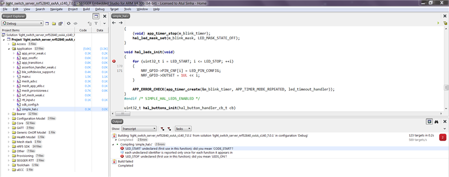

I am trying the example project "light_switch_server_nrf52840_xxAA_s140_7_0_1_dongle.emProject", facing some errors as show in image below:
If anyone has any kind of solution please help me in resolving this error .

You are probably getting the errors because there are no example project for the nRF52840 Dongle(PCA10059) in our Mesh SDK. You can use the examples by making some small modifications.
Have a look at this thread.
