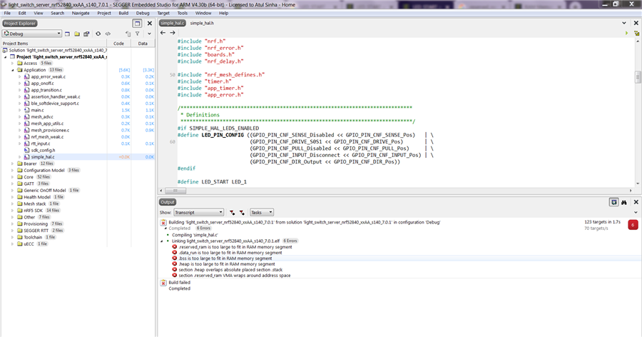

I am trying the example project "light_switch_server_nrf52840_xxAA_s140_7_0_1_dongle.emProject", facing some errors as show in image below:
If anyone has any kind of solution please help me in resolving this error .

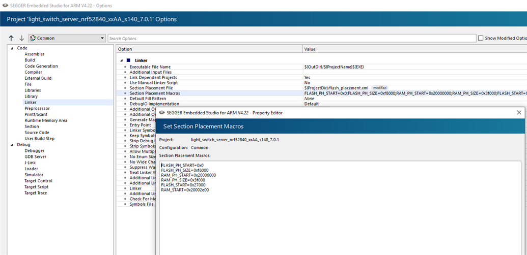

Seems like a RAM configuration issue. We don't provide an example for the nRF52840 dongle. I assume you created the project for the dongle ? Which modification did you add ?
Please double check the RAM setting, you should have something like this:
