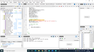

i am getting Fatal error while uploading code in my nRF52823 plz find attachment which i enclosed.
and showing break point at NRF_BREAKPOINT_COND; plz tell me what should i do ?
Thank you

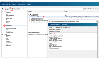

Try to add "DEBUG" to your preprocessor definitions, and see what the log says then.
1. Let me know if you are not sure how to define DEBUG in your preprocessor definitions.
2. The log will probably point to somewhere in your code where it says APP_ERROR_CHECK(err_code); What function call returned that err_code?
3. Your next mission is to find out why it returned that err_code.

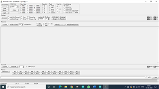

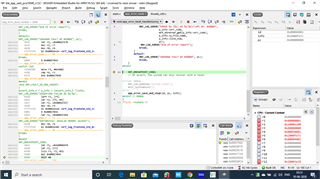

Thank you for replying fast
i added DEBUG in preprocessor definition as like this #define DUBUG
but i am not getting any msg in debug terminal

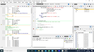

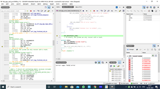

and one arrow (yellow color) indicating at NRF_BREAKPOINT_COND;
i dont know why this and i also attached a screenshot
Thank you

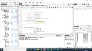

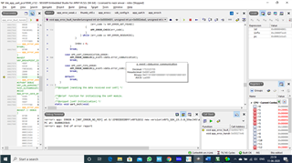

Edvin said:The error did not show up in the video. What did you change so that this issue occured?

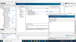

ok I used 16th version in my project
in which what I changed I wrote DEBUG in preprocessor definition (in COMMON mode)
After that, I changed NRF_FPRINTF_FLAG_AUTOMATIC_CR_ON_LF_ENABLED to 0 in sdk_config.h.
and last and finally i commented //APP_ERROR_HANDLER(p_event->data.error_communication);
after that 17th pin number led started blinking.
i connected via nRF UART APP to the BLE then LED stopped blinking.
But i am not able to receve on APP printf("\r\nUART started.\r\n");
and also not able to transmit
Thank you
and I am using pin P0.06 for TX and P0.08 is for RX
please reply
it was a problem with BLE internal pin that's why it was not working.
I changed pin configuration so it's working now.
so I am able to receive and transmit both
Thank you so much for the help,
