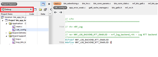

It seems like you got "id" also along with "PC". Since you narrowed the hardfault id to be NRF_FAULT_ID_SD_ASSERT. The line number and file name of the assert is located inside the info structure in app_error.h file
typedef struct
uint16_t line_num; /**< The line number where the error occurred. */
uint8_t const * p_file_name; /**< The file in which the error occurred. */
} assert_info_t;
Check if you have some valid structure here, if not then something is wrong. Are you seeing these values in a log or in a debug window? If it is the debug window, then i would suggest you to compile the code with no optimizations (and hope that the timing has not changed to be able to reproduce this error.) If you use segger, you can compile with debug mode.
-Amanda H.
