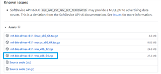

    I used the connectivity(connectivity_4.1.1_usb_with_s140_6.1.1) which was downloaded from https://github.com/NordicSemiconductor/pc-ble-driver/releases/tag/v4.1.1.
    The nRF52840 dongle only received 20 bytes, at the same time, Iphone can receive 240 bytes.
