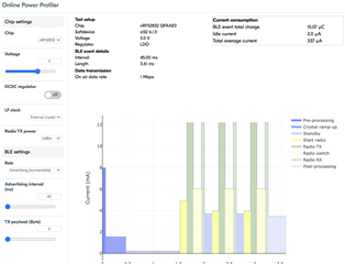

    On the Power Profiler app, when the radio is not running the baseline current is 1.9mA and the overall average is 2.26mA, so it's consuming 336uA during radio transmission, which looks exactly right compared to the online power profiler.
    Now I need to figure out why the baseline current is 1.9mA and if that's even a correct reading. And also the -0.24uA during sleep. The other posts make it seem like a setup issue with current leakage.
    edit: Ok, looks like UART consumes quite a bit of current. so that might be it. Still no answer on the negative current though. It'd be good to figure that one out so I can trust the readings that I'm seeing.
