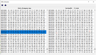

When analyzing the differences (after I started debugging), I notice that 2 addresses have been changed:
- 00FAE7E = 0x21 (before (NOK)) = 0x22 (after (OK))
- 00FAE80 = 0x22 (before (NOK)) = 0x21 (after (OK))
What are these addresses? Do you have any idea why it is only with the debug project that it works?
