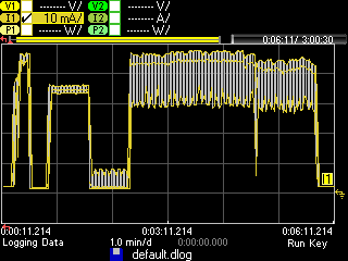

We found abnormal current waveform when running GPS as 120s fix interval and 10s fix retry.
As below pic, the first plus is A-GPS seraching, from second plus is the fix current, but you can see the second fix(third plus) has followed a very wide(it is far beyond 10s fix retry) current plus, what's the reason of this current plus?

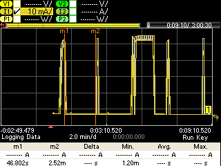

    We found the abnormal GPS operation will affect the LTE and GPS concurrent, the GPS fix will failed in below cases with fix interval 120s, 90s or 60s, fix retry is 0(indefinitely) ,10s or 20s.
    1, Start LTE before GPS get fixed;
    2, Start LTE before the 1 minute GPS abnormal period;
    How to get GPS fix easily and run LTE concurrently with low power consumption?

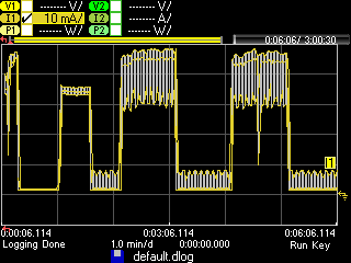

    Fix failed with interval 60s and retry 20s

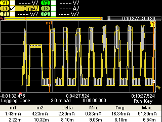

    Fix failed with interval 120s and retry indefinitely
    Fix failed with interval 120s and retry 60s

    In our testing, the GPS current pulse is about 50mA but the LTE current pulse is less than 40mA, as the picture in the first post, the LTE is disabled and all the pulses are GPS current consumption. After the third fix, the abnormal pulse's width is about 1 minute, what is the root cause of the abnormal current? from debug log, the GPS reported postion fixes every 1 second during the 1 minute abnormal current period, before or after that abnormal period, postion fix report interval was the configured 120s.
    In the second post, the purpose is to show the evidence that GPS could not get fix anymore if we start LTE after the first GPS fix. You can see the second pulse(about 30s wide and 35mA high) is the LTE searching and connecting current consumption, then LTE will enter into eDRX(AT+CEDRXS=2,4,"1000"). Our test result is:
    1, If we start/activate LTE after the first GPS fix, the subsequent GPS fix attempts will be failed, GPS will no longer to get new GPS fix;
    2, If we start/activate LTE after the fourth or the fifth GPS fix, then the GPS could work well with LTE concurrently.

    In 1st picture, the current pulse under marker m1 is the current consumption from start GPS to the first postion fix. The detail operations are as below:
    Enable GPS --> received NRF_GNSS_AGPS_DATA_ID --> suspend GPS by NRF_SO_GNSS_STOP --> start LTE and wait untill connected --> start SUPL session --> downlaod SUPL data is finished --> stop LTE -->resume GPS by NRF_SO_GNSS_START --> searching satellites and get postion fix --> GPS fix --> GPS interval --> GPS fix....
    The 2nd to 4th pictures were testing the concurrent of GPS and LTE, so the operations were same as 1st picture with additional operation to start LTE after A-GPS get first fix. That is:
    Enable GPS --> received NRF_GNSS_AGPS_DATA_ID --> suspend GPS by NRF_SO_GNSS_STOP --> start LTE and wait untill connected --> start SUPL session --> downlaod SUPL data is finished --> stop LTE -->resume GPS by NRF_SO_GNSS_START --> searching satellites and get postion fix --> start LTE --> connected to LTE network and enter into eDRX --> GPS fix --> GPS interval --> GPS fix....
    You can see the 2nd current pulse(about 30s wide) is device to search, connect to LTE network and then enter into eDRX, and after connected to nwk, there is no any further send/recive packet operation in LTE nwk, so all the subsequent pulses(from 3rd pulse) are the current of GPS fix retry, and all the fix retry were timeout/failed. (Note: the issue only happened when GPS fix interval is 120s or 60s, will not happen if GPS fix interval is 1s and fix retry is 0)
    Q1, In picture1, what's the reason of the 1 minute wide abnormal current pulse?
    Q2, According to the picture2~4, why the GPS could not get fix anymore after started LTE network?
