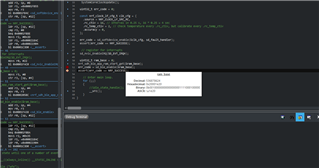

nrf52833 NRF_ERROR_NO_MEM
I am having an issue with the nRF52833. I'm using the NRF5SDK, version 16, and the SoftDevice s113 version 7.0.1. I can take the ble_app_uart example from the sdk (located here: /examples/ble_peripheral/ble_app_uart/pca10100/s113/ses/main.c) and replace the main method with this, and it works:
#include "assert.h"
#include "nrf_sdm.h"
static void sd_fault_handler(uint32_t id, uint32_t pc, uint32_t info)
  while (1){};
   SystemCoreClockUpdate();
  uint32_t err_code = 0;
  const nrf_clock_lf_cfg_t clk_cfg = {
    .source = NRF_CLOCK_LF_SRC_RC,
    .rc_ctiv = 16, // Interval in 0.25 s, 16 * 0.25 = 4 sec
    .rc_temp_ctiv = 2, // Check temperature every .rc_ctiv, but calibrate every .rc_temp_ctiv
    .accuracy = 0,
  err_code = sd_softdevice_enable(&clk_cfg, sd_fault_handler);
  assert(err_code == NRF_SUCCESS);
   // register for interrupts
  sd_nvic_EnableIRQ(SD_EVT_IRQn);
  uint32_t ram_base = 0;
 nrf_sdh_ble_app_ram_start_get(&ram_base);
 err_code = sd_ble_enable(&ram_base);
    // Enter main loop.
    for (;;)
        idle_state_handle();

    I'm afraid I can't of anything that could explain why the RAM_START got changed after you moved the project outside of the SDK tree. But RAM_START=0x20001058 is too low, at least with the default configurations. I get "0x20001e20" as the lowest start address here:
    Please try and see what the ram_base is after the program has returned from sd_ble_enable, then make sure the RAM_START setting matches this value.
    Edit: Forgot to add that RAM_SIZE size must be adjusted as well so that RAM_START+RAM_SIZE don't exceed RAM_PH_START+RAM_PH_SIZE
  • Hello Vidar,
    Unfortunately I tried that already. I updated RAM_START to 0x20001e20 and RAM_SIZE to 0x1e1e0 but I got the same error code. I feel like something simple is wrong but I'm not sure what it is. It seems strange to think that just moving the project to a different directory would be the cause.
  • Can you try and see what ram_base gets set to after calling nrf_sdh_ble_app_ram_start_get()? It should be the same as RAM_START.
    I don't recall running into this problem at least. I have shown how I usually move projects outside of the SDKs file structure here if you want to compare: https://devzone.nordicsemi.com/f/nordic-q-a/62122/best-practices-for-starting-a-new-project-in-ses-based-on-example-application but it looks like you are already doing the same.
  • I re-copied the example, set a macro for SDK_ROOT, and got it to work (third/fourth time). I'm guessing something was getting corrupted in the .emProject file (during the process of renaming the include paths) but for some reason it wasn't so bad this time. It's also possible that I had copied a configuration parameter wrong.
    Anyway, Vidar, thank you for helping verify the memory layout, for the helpful links to the Nordic documentation, and for the advice about best practices for moving an example.
    Also, to answer your question, I verified that ram_base was getting set to RAM_START by nrf_sdh_ble_app_ram_start_get(). And when I initially got the error code, I updated RAM_START to the value ram_base was set to by sd_ble_enable().
  • Thanks for the update, I'm glad to hear that it works now.
    It sounds like you are doing everything correctly. I assumed it had to be a mismatch between the address returned from nrf_sdh_ble_app_ram_start_get() and RAM_START. Anyway, just let me know if you run into this problem again.
