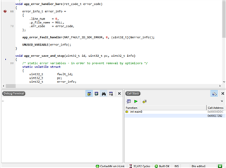

- I´ve tried to debug, but debug terminal is empty (screenshot 1 attached).

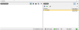

- Do I set the breakepoint wrong or why is there a question mark (screenshot 2 attached)?

    This makes me think that the application gets stuck before entering your added TWI code. I would guess that you've changed some configuration that causes the SoftDevice to fail its enabling, or something similar.
    Could you set Segger Embedded Studios to "debug" mode(top left corner), and use debug mode to step through your code to see if you can find any error calls?
    Does the device reset, or just become stuck in a loop somewhere?
    Where do you end up when you step through your code while debugging?
    Do you enter any of the error handling functions.
    Hover over the breakpoint in question to see its warning. In your case, it is because the declaration of a struct is done during compiling - not at runtime - which means that the breakpoint you have set is actually not a CPU instruction, where the CPU may halt. Rather, you could place the breakpoint on line 73 instead.
