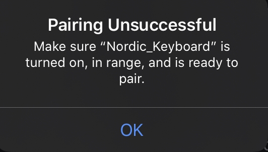

I'm trying out the HID Keyboard example (sdk 16.0.0, s132) and was able to pair once to my phone. Now I can't pair to any device. The following pop-up window appears on my phone.
Any thoughts on how to fix it?

Hi Ricky,
Did you delete bond information on the phone side? If so, you have to reset the device while pressing Button 2 to erase bond info. Then you can bond and connect the phone and device again. If you still have the issue, please provide the debug log.

For anyone that might find it useful, I was able to allow repairing with the following highlighted lines:
