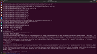

I tried to change the path but didn't work for some reason.
Hi!
What NCS tag are you on?
at_cmd_parser.h was moved to ncs/nrf/include/modem a few tags back, so all includes of this file should be #include <modem/at_cmd_parser.h>
Just changing this line won't work, as there are probably a lot of there small changes made. You need to make sure when running an older application, that you run it in the correct NCS tag.
