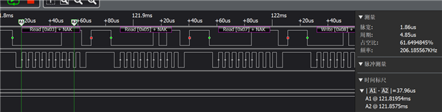

  • thank for your reply.And your answer take me some mind to slove this problem.i find the pca10056 in my hand cant achieve 400k speed. i set the speed 400k,actually it is 206k .and i set it 250k,it work at 250k.first i tink my code have not set correctly.and than i modify the speed of project nRF5_SDK_16.0.0_98a08e2\examples\peripheral\twi_sensor
    the problem also occured. the 400k cant achieve.so is there any config i have not set correctly?
    the speed test on 400k speed set:
    the code i modify in the project twi_sensor:
    the speed test on 250k speed set:
  • I compiled the twi scanner example:
    \nRF5_SDK_15.3.0_59ac345\examples\peripheral\twi_scanner
    Then modified twi_init():
    void twi_init (void)
        ret_code_t err_code;
        const nrf_drv_twi_config_t twi_config = {
           .scl                = ARDUINO_SCL_PIN,
           .sda                = ARDUINO_SDA_PIN,
           .frequency          = NRF_DRV_TWI_FREQ_400K,
           .interrupt_priority = APP_IRQ_PRIORITY_HIGH,
           .clear_bus_init     = false
        err_code = nrf_drv_twi_init(&m_twi, &twi_config, NULL, NULL);
        nrf_gpio_cfg_input(ARDUINO_SCL_PIN, NRF_GPIO_PIN_PULLUP);
        nrf_gpio_cfg_input(ARDUINO_SDA_PIN, NRF_GPIO_PIN_PULLUP);
        nrf_drv_twi_enable(&m_twi);
    Can you repeat the same?
