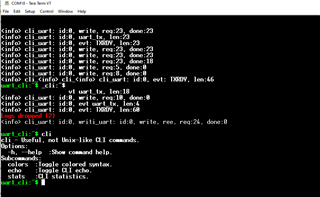

Hi - I am trying to create a CLI project with FreeRTOS , the project will be used as an aggregator .
I can not figure out why I can't enable CLI , code hangs. would appriciate if you can take a look . pls. set BUILD Macro called "NRF_SDK_DIR" that points to 15.2 SDK.
  • Ran,
    You are right, there was a bug in app_timer_freertos.c file in SDK15.x that was was fixed in SDK16. Attaching the file for your convenience. Please replace the file in SDK15.2\components\libraries\timer\app_timer_freertos.c with the attached file
    I did not see NRF_CLI_ENABLED enabled in the attached project, probably you have it enabled in your local copy.
