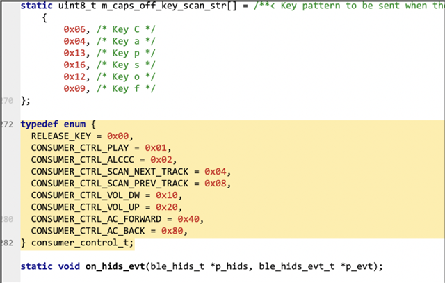

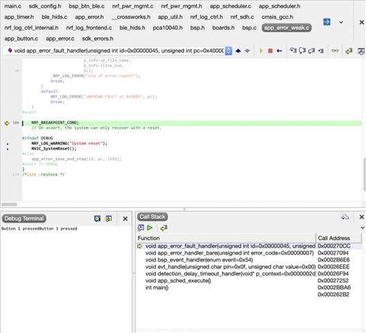

I've been playing around with the nrf52 DK (sdk 16.0.0, s132). I'm trying to add volume up/volume down functionality to the example. I found this source code from an earlier SDK and I've been trying to follow the changes in SDK 16.0.0  https://github.com/Rallare/nrf51_ble_app_hids_kbd_consumercontrol/blob/master/main.c
So far I've added everything highlighted

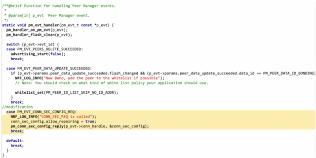

1) The following changes were added to allow for repairing. This works fine.

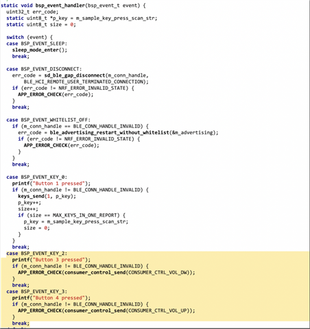

2) The following code was added to allow button 3 and button 4 functionality on the nrf52832 board. This works fine (I can see the printf statements in the debug console when I press the buttons).

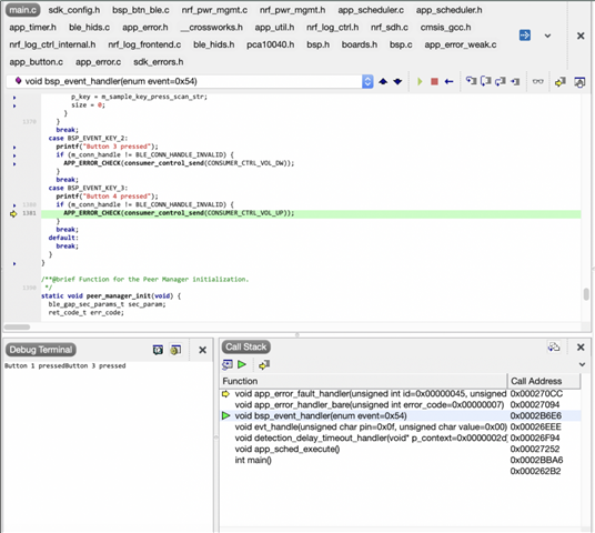

3) Now here it gets tricky. I'm trying to utilize the ble_hids_inp_rep_send() function to send data. So I've added the following
 - enum to organize commands
 - helper function
 - the following constants
 - and the following lines inside the hids_init() function:

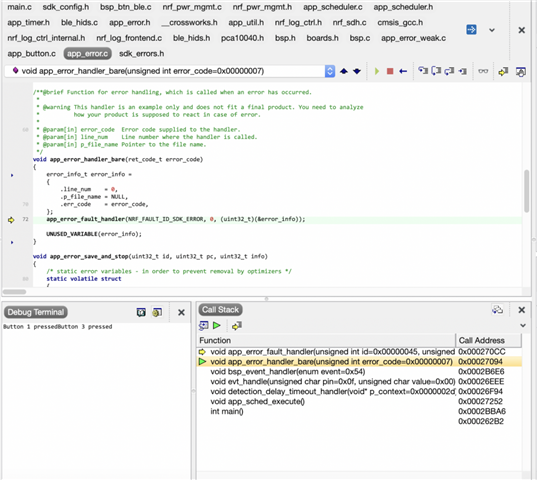

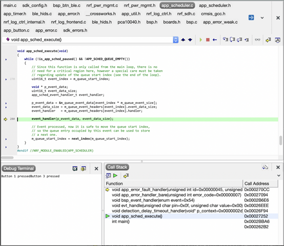

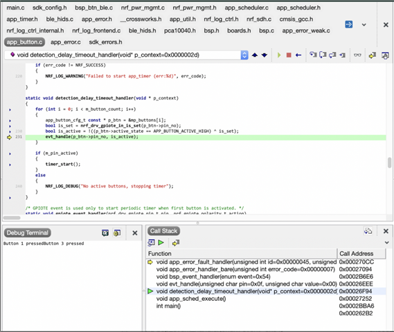

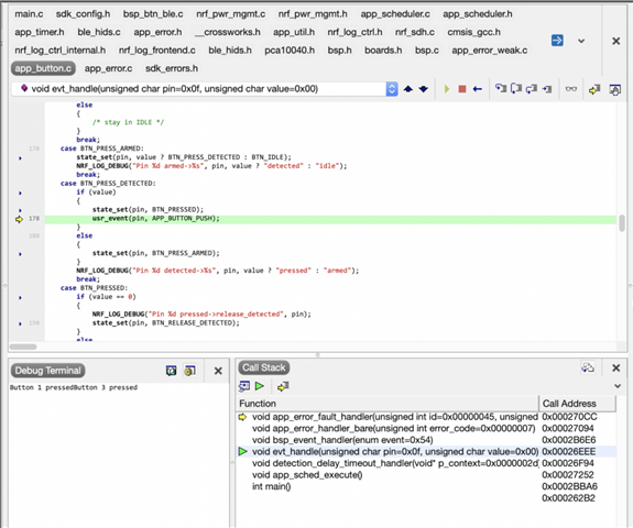

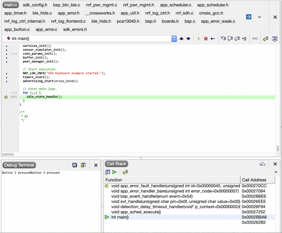

Clearly I'm missing something or I'm doing something wrong since when I run it and click on button 1, it works fine, but when I click on either button 3 or 4 the following error occours (here's the stack trace):
NOTE: consumer_control_send() is the function that I added.
If you could help me out to figure out what's wrong or point me in the right direction I would be very much obliged!
Also I have attached main.c in case you would like to run it Slight smile
Best,
Ricky

typedef enum {
  RELEASE_KEY = 0x00,
  CONSUMER_CTRL_PLAY = 0x01,
  CONSUMER_CTRL_ALCCC = 0x02,
  CONSUMER_CTRL_SCAN_NEXT_TRACK = 0x04,
  CONSUMER_CTRL_SCAN_PREV_TRACK = 0x08,
  CONSUMER_CTRL_VOL_DW = 0x10,
  CONSUMER_CTRL_VOL_UP = 0x20,
  CONSUMER_CTRL_AC_FORWARD = 0x40,
  CONSUMER_CTRL_AC_BACK = 0x80,
} consumer_control_t;
static void on_hids_evt(ble_hids_t *p_hids, ble_hids_evt_t *p_evt);

//modification
  case PM_EVT_CONN_SEC_CONFIG_REQ:
    NRF_LOG_INFO("CONN_SEC_REQ is called");
    conn_sec_config.allow_repairing = true;
    pm_conn_sec_config_reply(p_evt->conn_handle, &conn_sec_config);

/**@brief Function for sending consumer control data
static uint32_t consumer_control_send(consumer_control_t cmd) {
  return ble_hids_inp_rep_send(&m_hids, INPUT_CONTROL_KEYS_INDEX, INPUT_CONTROL_KEYS_MAX_LEN, (uint8_t *)&cmd, m_conn_handle);

  case BSP_EVENT_KEY_2:
    printf("Button 3 pressed");
    if (m_conn_handle != BLE_CONN_HANDLE_INVALID) {
      APP_ERROR_CHECK(consumer_control_send(CONSUMER_CTRL_VOL_DW));
  case BSP_EVENT_KEY_3:
    printf("Button 4 pressed");
      APP_ERROR_CHECK(consumer_control_send(CONSUMER_CTRL_VOL_UP));

    It seems like the error code is 0x07 (NRF_ERROR_INVALID_PARAM), and that this comes from the call to ble_hids_inp_rep_send() in consumer_control_send(). Looking at the source code in the SDK, this function will return this error if the rep_index parameter is not smaller than the configured p_hids->inp_rep_count.
    In your hids_init() function, you set the count to 1 (hids_init_obj.inp_rep_count = 1), while you have defined INPUT_CONTROL_KEYS:INDEX to be 1 (i.e. not smaller than 1). Increasing the config should solve this issue.
