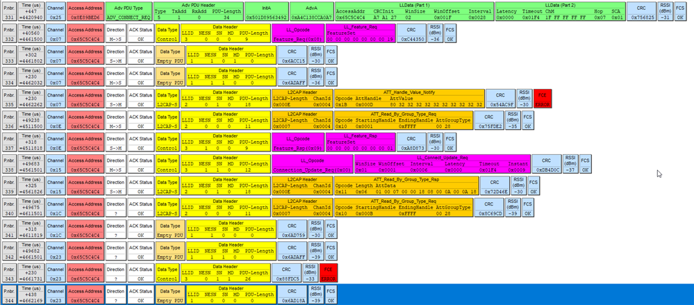

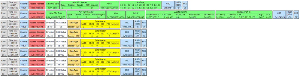

Sniffing result for failed connection:

    Sniffing results:
Do you have any suggestions how we can fix it?
