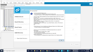

I am using nRF Connect SDK v1.3.0 tag for nRF52840 DK.
I am trying to integrate BLE HCI UART project files into Zigbee light switch project.
I have attached modified
app.overlay

files in Zigbee light switch project  with configuration from Zephyr BLE HCI UART.
Attached error while generating SES project.
Please point out the integration issue.
Please take a look at the attached Zigbee light switch modified project.
