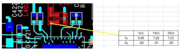

Let me know How to measure RX Sensitivity by  TESCOM TC-3000
My S.W engineer setup TX power +8dBm then He wants to know How can it measure Rx Sensitivity
nRF52840_PS_v1.1 describe  on "6.20.15.5 Receiver operation"
that introduces some case "P rx,MAX, Psent,it,1M..."
But I don`t think I can setup it when I setup for DTM mode
Pls ref below picture that is my result data of testing

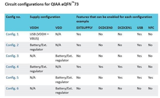

(3) If VDDH and VDD power are disconnected from the table below, should the same external LDO power be supplied when using external LDO power?
(4) Does the table below mean that EXT-SUPPLY uses external LDO?

    I am not familiar with this tester, but per the Bluetooth spec there is only a requirement that the DUT shall have a sensitivity of -70dBm or better. The tester might just test for this and not allow you to manually change the input power, but you can do this externally using attenuators.
    Another possible solution is if there is a way to measure the BER or PER. Lower the input signal strengt (in the instrument or by attenuators) until the BER or PER is below the threshold limit.

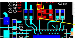

    You seem to have gotten it to work properly though. The sensitivity you measure is a bit worse than the spec, but your layout also differs quite a bit, which might be the cause. You should also make sure to measure in front of the matching network:
    Andreas
