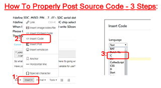

    What Awneil pointed out is that by using the insert->code option the readability of your code drastically increases, and thus it will be easier to help you.
    It will also make it more likely that someone in the forum will spot and point out your issue, which could lead to a faster response.
