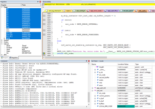

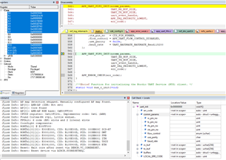

  • Karl, Thank you!
    1. This sample program is the official source code, I have not made any changes.
    2. Before crash, execute nrfx_uarte_rx(), see return error code below.
    3. This is the parameter data before APP_UART_FIFO_INIT() enters
    4. Enter the parameter value of crash.
    5. log file
