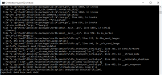

but problem in serial DFU is when it stop in between mean serial DFU is running and due to some problem(power cycle or else) it stop then we will start it but it will not start again and reported this error
"pc_ble_driver_py.exceptions.NordicSemiException: Unexpected Executed OP_CODE.
Expected: 0x03 Received: 0x64"
Error Image:
