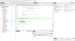

Im trying to interface ADXL345 with nrf52DK via I2C. Im using the reference drivers in below link
https://devzone.nordicsemi.com/f/nordic-q-a/40822/adxl345-and-nrf52832
i edited the main function to include twi_handler,

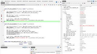

the control when trying to enable the TWI, enters the twi_enable function, after completing the function last line( at last breakpoint) , goes into NRF_BREAKPOINT COND.
Can you kindly help me resolve this?

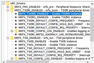

wrt sdk settings,
what all should be enabled? what not. such as NRFX_TWIM and NRFX_TWI and TWI
