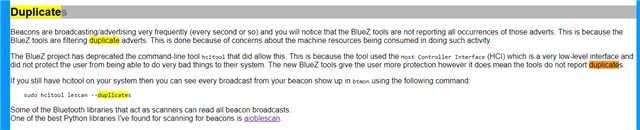

Scanning without duplicate packets in one scan window
Is there any way I can scan for a short period of time with a duplicate filter on so that I only get 1 packet form the advertising device in one scan window.
For example.
Scan Window 500 ms
Scan interval 10,000 ms
Other device advertising at 100 ms
In this case if the duplicate filter is on I should only get 1 packet in one scan interval, which is 10 seconds, instead of 5 packets.
I am using SDK 16.0.0 with softdevice S132. IDE Keil.
