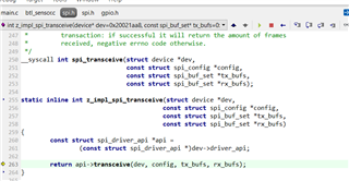

NRF5340-"spi_transceive"cause a bus fault in SPM application
 I  Separate two projects ,SPM application and  non-secure application.the spi driver can work in  non-secure application,when I try to transplant the spi driver in SPM application,a bus fault occured
log:
[00:07:38.250,549] [1;31m<err> os: ***** BUS FAULT *****[0m
[00:07:38.250,579] [1;31m<err> os: Precise data bus error[0m
[00:07:38.250,579] [1;31m<err> os: BFAR Address: 0xd[0m
[00:07:38.250,579] [1;31m<err> os: r0/a1: 0x00000000 r1/a2: 0x00000001 r2/a3: 0x00000141[0m
[00:07:38.250,579] [1;31m<err> os: r3/a4: 0x00001703 r12/ip: 0x00011fb8 r14/lr: 0x200113b0[0m
[00:07:38.250,579] [1;31m<err> os: xpsr: 0x0000a400[0m
[00:07:38.250,579] [1;31m<err> os: Faulting instruction address (r15/pc): 0x00000141[0m
[00:07:38.250,579] [1;31m<err> os: >>> ZEPHYR FATAL ERROR 0: CPU exception on CPU 0[0m
[00:07:38.250,610] [1;31m<err> os: Current thread: 0x00000000 (unknown)[0m
[00:07:38.320,861] [1;31m<err> fatal_error: Resetting system[0m
the gpios and spi is initialized before "spm_config()",when run into "spi_transceive",the bus fault occured!  when there is no spi driver ,the SPM application can jump into non-secure application successfully.

"bf_spi_write(1)"  calls "spi_transceive()",when run into spi_transceive,the bus fault occured!
