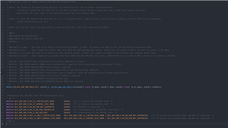

down in the function I mentionet already is a call to
sd_ble_gap_adv_data_set() this function gives me the error code 10 -> Invalid Flags
I extracted some defines from this function the hole definition is defined in ble_gap.h
the value witch is given to the function in *p_data has a flag field witch is 6
but 6 is not an invalid flag as you can see
#define BLE_GAP_ADV_FLAGS_LE_ONLY_GENERAL_DISC_MODE   (BLE_GAP_ADV_FLAG_LE_GENERAL_DISC_MODE | BLE_GAP_ADV_FLAG_BR_EDR_NOT_SUPPORTED)   /**< LE General Discoverable Mode, BR/EDR not supported. */
is in fact flag value 6: because 0x2 | 0x4 is 0x6 ... so far so bad, whats wrong now?
