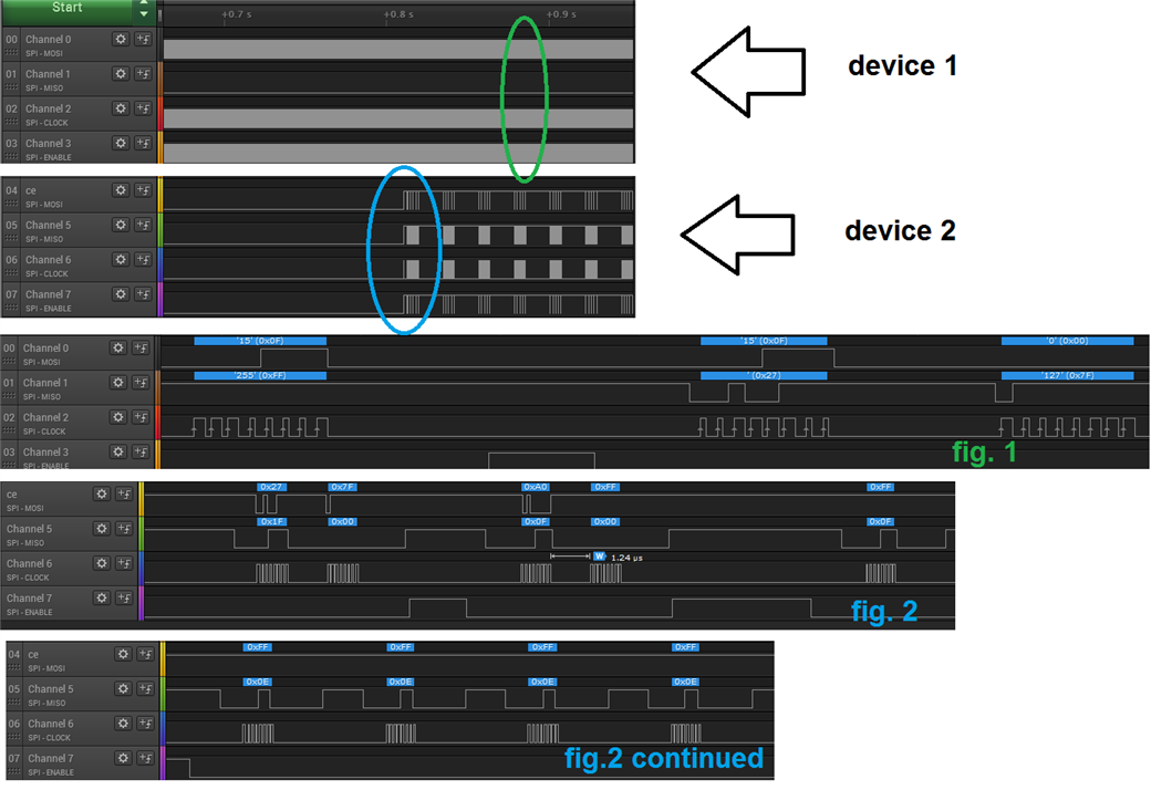

Can not get my two device to talk in a working environment.
I have already set up a successful sender and receiver. The receiver was using an arduino board and the sender a avr at90usb162.  I have now removed the arduino and moving closer to pre-production but getting a bit of a snag.
The two device must be able to detect one another. The current code I have does the following.
Device 1) Loop a status register check followed by an immediate  clear int's (0x27, 0x7f). The idea is if the status register ever sees a 0x40 or maybe 0x20 we know it saw data.
I was hoping an 0x20 would work but it didnt, so I added a ox40 but they never are set.

Here are some details, note fig.1 is always 0x0f. The idea is it should go to 0x2f when the data arrives.
NOTE2:
both modules are with in 4 inches because I need to use the same analyzer. If that is an issue, what can I put between them (foil?) ?
Both chips are the same hex, the only difference is the init code is set with a 1 or a 0 to select the operational mode.

  • wow, simple issue... My dataready was missing the CE high. I forgot that needs to be held high to receive. but now its not Ack'ing back like it does when the arduino talks to it.  So I'm still missing something,
    for my receiver I do this.
            ATT_ON(); //forces all commands to send right away, puts device in receiver mode.
            enable();//set ACK payload
            sendCommand(0xA8);sendCommand(0x0A);
            disable();
     but my transmitter device never receives the ack. As soon as I plug in the ardunio  receiver and run my code the ardunio gets an ack back. So  know my auto acking is all set up correctly on the transmitter end.  The receiver code is the same as the transmitter code except for the PTX and code I put above. Is there another bit I need to set other then the 0x00 register ( 0: PTX ) mode and leaving CE high? The transmitter sends data, my receiver receives it and I can read the correct data in the buffer but it never acks back.
  • Take a look at the code that I shared, this is the minimum required code for a PTX and PRX with ACK, once you have verified that works it is easier to move to your specific configuration.
  • Yes the code examples work as does my preview set up. I'm just simply missing something in writing the new receiver code.
