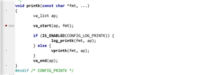

  • More info.  If I set a debut point inside printk.c / printk(), it gets called in the first version.  I can break on it, study parameters, all that.  In the NS version, it never gets called.
    Something is optimizing out the printk() calls in the NS build.  Anyone know what that might be?

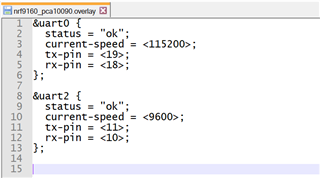

    Oh, also my overlay files in the original post have some garbage in them.  Let me try to clean that up.
    &uart0 {
      status = "ok";
      current-speed = <115200>;
      tx-pin = <19>;
      rx-pin = <18>;
    &uart2 {
      status = "ok";
      current-speed = <9600>;
      tx-pin = <11>;
      rx-pin = <10>;
    That should look like this, if I did it right this time.

  • I'm pretty sure nothing else is using those pins.  If I do the above recipe and select nerf9160_pca10090 as the board, I get output, so I know my hardware and my overlay files are ok.  It's just when I select nerf9160_pca10090ns, I don't get output.  And if you use the interactive debugger inside printk(), you can see it never gets called in the NS build.  It's as if something is optimizing out the calls to printk().  The problem seems to be a build problem.  I've seen other build systems (like Windows CE 6.0) that take all the debug calls out during a Retail build.  I'm guessing it's something along those lines, I just can't find it.
