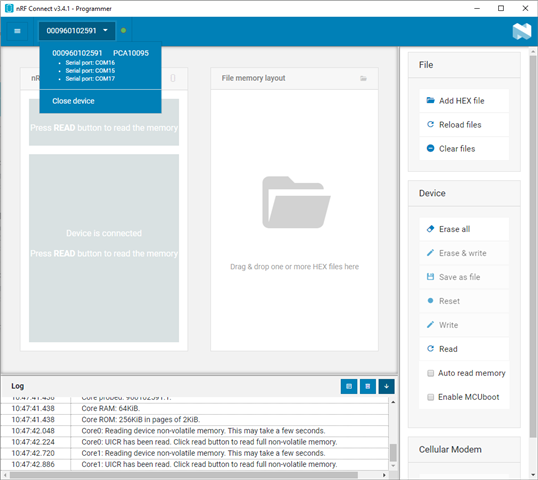

The device 'A106E6L9' doesn't seem as a valid nRF kit, it should be something like this:
Are you sure that the nRF kit it turned ON (LED turned ON) and have enumerated with the USB port (check device manager in Windows for J-Link driver and COM ports when attaching nRF kit)?

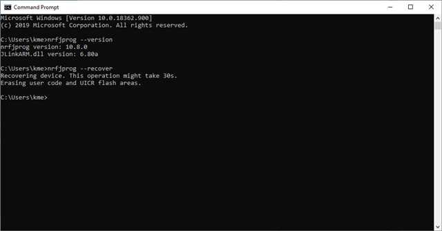

You can also try to run nrfjprog from command line to check if you get the same as here:

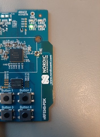

What is printed on the label of the nRF53 PDK you have?
Hi Kenneth
The label on the box is nRF6835, Rev.0.8.0. 2019.51
The unit is turned on. Led5 is blinking and I can control the LED1-LED4
