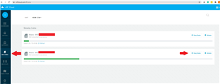

    I am using a SIM card that came with nRF9160DK board (iBASIS eSIM). Where can I actually check how much data is left and how can I recharge the card?
    Bojan.
  • Hello Bojan,
    If you are using the iBasis Sim card you can check it on nRFCloud. Log in with the same account that you used to activate the sim card.
    Then go to the SIM CARDS tab to the left and you should see the status of your sim cards. Click refresh beneath the SIM card you are using to make sure the information is up to date. You can use the "+ Buy Data" option to refill the SIM Card:
    NB: I am not sure whether it is still like this, but it was at some point in time.
    If you buy 10MB for an iBasis SIM card, you top it up to 10MB. This means that if you have 5MB left, and buy 10MB, you will only actually receive 5 new MB, and the new remaining data will be 10MB in total. I am not sure if this has changed or not, but if you are all out, there is no loss in buying 10MB :-)
    BR,
    Edvin
  • Just checked, ... My SIM card was indeed out of data!
    I recharged the card and voila! I was able to communicate with the Thing on AWS IoT Cloud!
