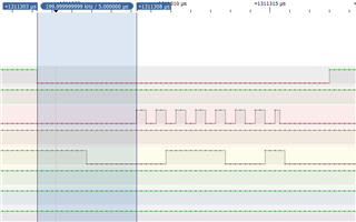

Yes Jared .. current my implementation is like that only but i see 5usec delay between the CS LOW and the start of clock
5 µs is within what's expected.
