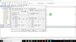

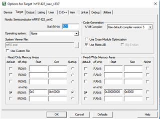

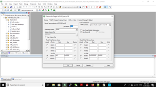

I generated boot-loader (logging disabled) from SDK 12.1.0 for adding a signature check during DFU for nRF51
The problem I am facing is with the size of bootloader (hex file size 56,871 bytes).
Previously I was using bootloader (hex file size 40,050 bytes) generated from SDK 11.0.0
Application hex file size is 161,287 bytes
Soft device: S130: 305,123 bytes

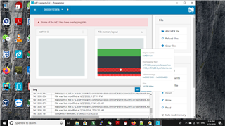

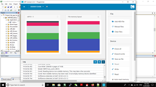

While writing into flash through nRFgo Studio, I am following this sequence:
1. Upload Soft device hex file
2. Upload Application hex file
3. Upload bootloader hex file
On step 3 I am getting error "This hex file has data in SoftDevice region"
What are different ways to get over this issue?
